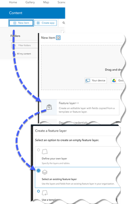

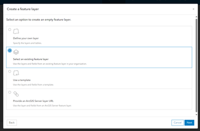

With the February 2025 release of ArcGIS Online, when you add a new item—Feature Layer that is based on an existing feature layer, the layer definition (symbols, labels, forms, etc.) will be included in the new feature layer. You will have the entire schema of the source feature layer including layer definition with no features in the new layer.
You just need to save the properties you want with the layer.

@TanithLives  No, I don't think there is a way to create custom templates at this time.   However, in Field Maps Designer you can create a new map and "Start with no layers."   Then in designer just add the layer created as described in my previous post.  You will see the forms load in from the layer once it is added.   With the underlying functionality for creating new layers from existing layers and retaining all layer properties in place, it seems there are opportunities to enhance the template experience. @SarahSaint-Ruth
