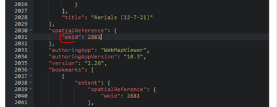

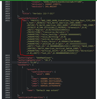

Have you used AGOL Assistant to check if the spatialReference property of the basemap layer is set to wkid 3438 rather than the wkt description? Check this in the JSON file for the map (rather than the layer). The description is much longer than the wkt. See the two graphics below. To be clear, spatialReference should be set to "wkid": 6381.
If you find this is the problem, you will need to make this change manually every time using AGOL Assistant after saving the map with Map Viewer or Map Viewer Classic.

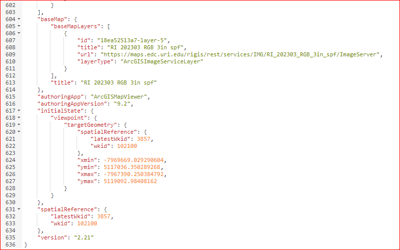

Thank you very much for this thought on using AGOL Assistant.  It does seem to expose an issue with the base map as the WKID is supposed to be 3438 (102730) and it is showing in the JSON as 3857 (102100).  Do you think if I manually change this it might work?
PaulLohr
You're welcome.
I don't think changing the WKID to one that doesn't match that of the ImageServer service will work. You could try it though.
If the aerials actually use WKID 3438 (rather than 3857 / 102100), the imageServer service could have its coordinate system changed (data frame) then recreate the service. Chances are those aerials use State Plane coordinates (rather than WGS 1984 Web Mercator; WKID 3857 / 102100). You may need to remove and re-add the basemap to force the change. The key is to get that WKID to change to 3438 in the JSON code.
