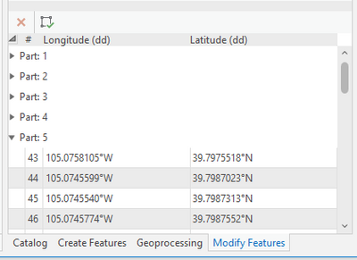

I have posted on this in the past but never got an answer.  I always assumed multipart support is long gone.  But today I had a user that managed to create a polygon with 3 distinct, not connected, parts.  I have been trying to recreate it but I cannot.  I do however seem to be able to create multipart something according to Pro.
If a use a combo of adding points manually and streaming I can make some crazy shapes.  It seems to let me do anything.
Looking at this shape in Pro it has 5 "Parts" listed.  Not sure where it is getting this?

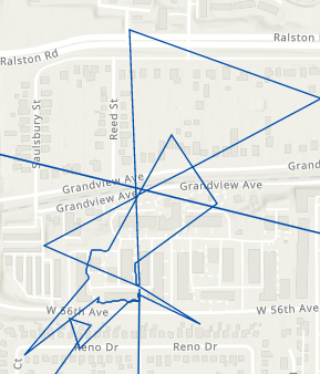

Finally found an answer! Basically what happened in my case is a simple editing of the vertices:
  • The polygon is first edited in a way that creates self-intersections
  • Even if there are no vertices on the intersection, the system (FieldMaps but also tested in Map Viewer on browser) will create a vertex upon update/submission (see second picture, those vertices didn't exist before self-intersection)
  • Then, the user re-select the feature for further editing and add/deletes some vertices (in this case the ones of the "middle" triangle)...and there it is, a multipart polygon! (third picture)
This works both online and offline as they can keep editing features indefinetely!
