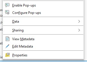

If you disabled Pop-ups for one layer, it looks like this when you right-click the layer in the contents area of your map:

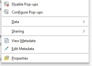

When you enable Pop-ups, it looks like this:
dsinha
@HannesVogel Thanks for that suggestion! I was troubleshooting with an ESRI analyst yesterday and it seems the problem might be with the EGDB itself where the feature layer resides. I will report back when we are able to identify what exactly caused this problem.
