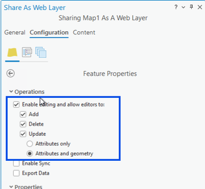

then go to the Configuration Tab and click the pen-icon
then enable the editing options you want to allow the editors:
then publish and add the featureservice to your webmap. At which point occurs a problem on your side?

Thanks @HannesVogel! Yes, I did all activate those settings. The problem happens when I open the layer in the Field Map Form Builder. I get errors indicating that I have not set up the properties correctly (see attached screenshot) and I am not able to design the form or save it.
