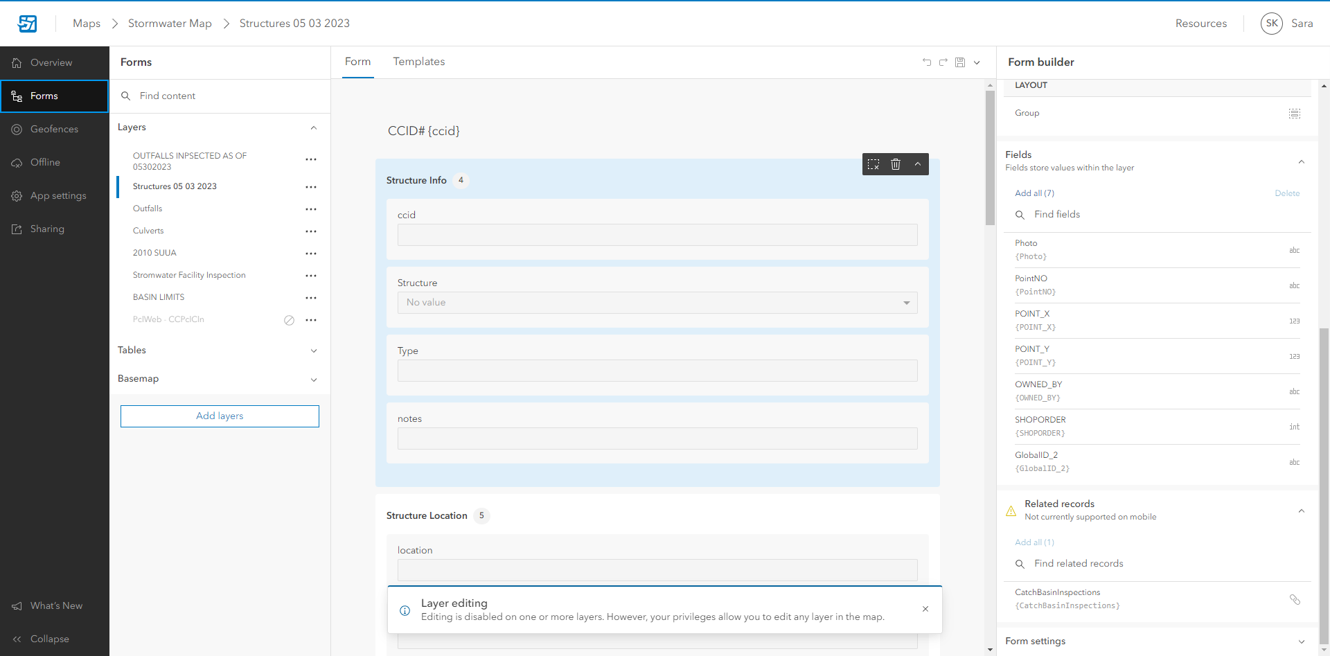

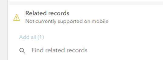

My coworker is getting this error:
Related Records not currently supported on mobile.
It is my role to help her troubleshoot when she has issues. How do I know if there is an issue with her data or the field map designer tool?
In field maps she can see the related table and can edit it and the edits are syncing to her online map.
But she can't view or modify the related table in the field map designer tool. She said that it was working this morning.

We just figured it out.
When she opened the map in Field Map Designer, she dragged the related table into the form for the point dataset that it was related to thinking that this would be necessary for the related records to show up in the form.
But this wasn't necessary to get the related table to show up in field maps, it was kind of like a redundancy that showed the error message.
As soon as she removed the related table from the form of the point layer the error message went away.
She tested it in field maps and was able to see the related records in her point layers form.

Gisbert61
Same error here, I have an existing hosted feature class with related table and on opening the field maps designer, choosing the map and the feature layer this error occurs.
By the way; i created a new and empty feature class and related table as per (https://support.esri.com/en-us/knowledge-base/how-to-set-up-related-tables-in-arcgis-pro-for-use-in-... and published this to my online. After opening the field maps designer, you guessed it: same unwanted error.

Same issue here.  Add all is greyed out for some reason.  Can not add any related records at all now.  I do not have any related table fields in my form.  Started an all new map and form and still no.  Totally stuck now.

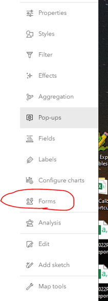

I think I figured mine out at least.  You must go through the Forms Designer from Map Viewer then it will let me add the related.  While you can use Field Maps Designer to design forms and Map Viewer picks up those forms the options in Field Maps Designer are slightly different.  They seemed to be interchangeable but they are not.  They both look and act the same.
Hope that helps someone.

In order to use the related feature you cannot use Field Maps designer is what I found.  You have to go to the form designer from the map only.
