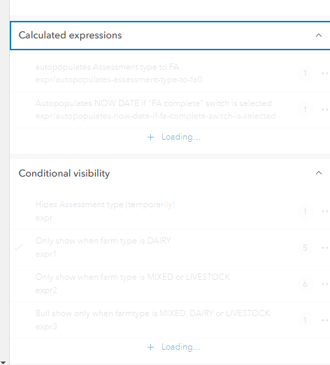

just wondering if anyone else sees this behaviour in Field Map. I have 20 or so calculated expressions and a few conditional visibility statements in my table form but when I try to add or edit any of them it just freezes and hangs, saying "loading". It never actually opens Arcade editor. Anyone else seen this ?

It was the busted WMS in the webmap that was causing the Arcade to freeze up.

Hi @KyleMcElroy. So sorry for the mega delayed reply. I have 10 or so WMS layers in a webmap and periodically they must get taken "offline" by the Scottish Government for admin etc and when this happens the arcade editor never opens. In fact I am experiencing this very thing once again today as ALL of the WMS feeds are offline and I cannot work on the webmap and field map forms at all. The webmap does open eventually (3-4 minute hang) and so does field map but the arcade editor never opens and just sits like this (attached).
