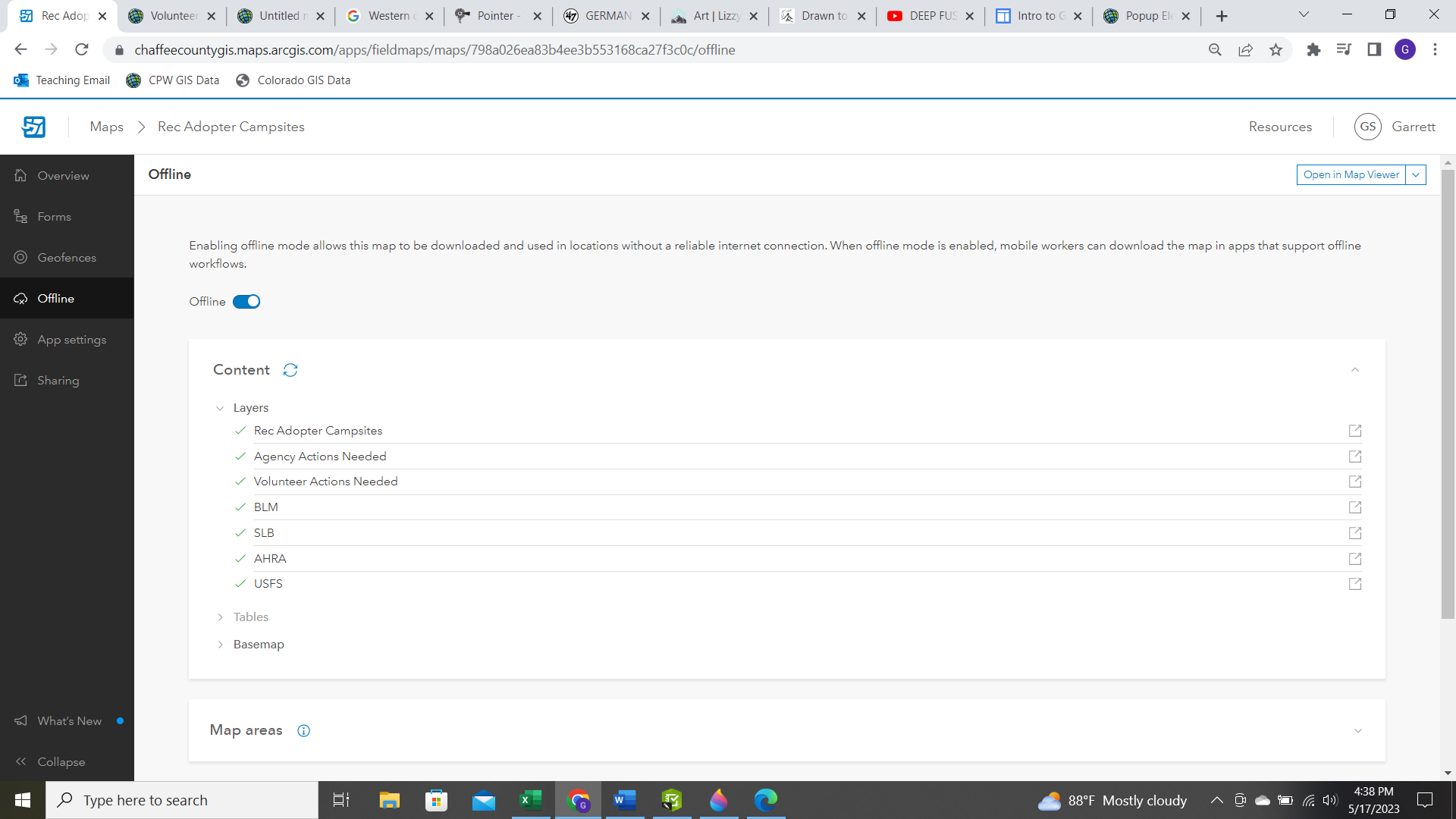

Here is the map that I am using, including the layers:

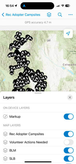

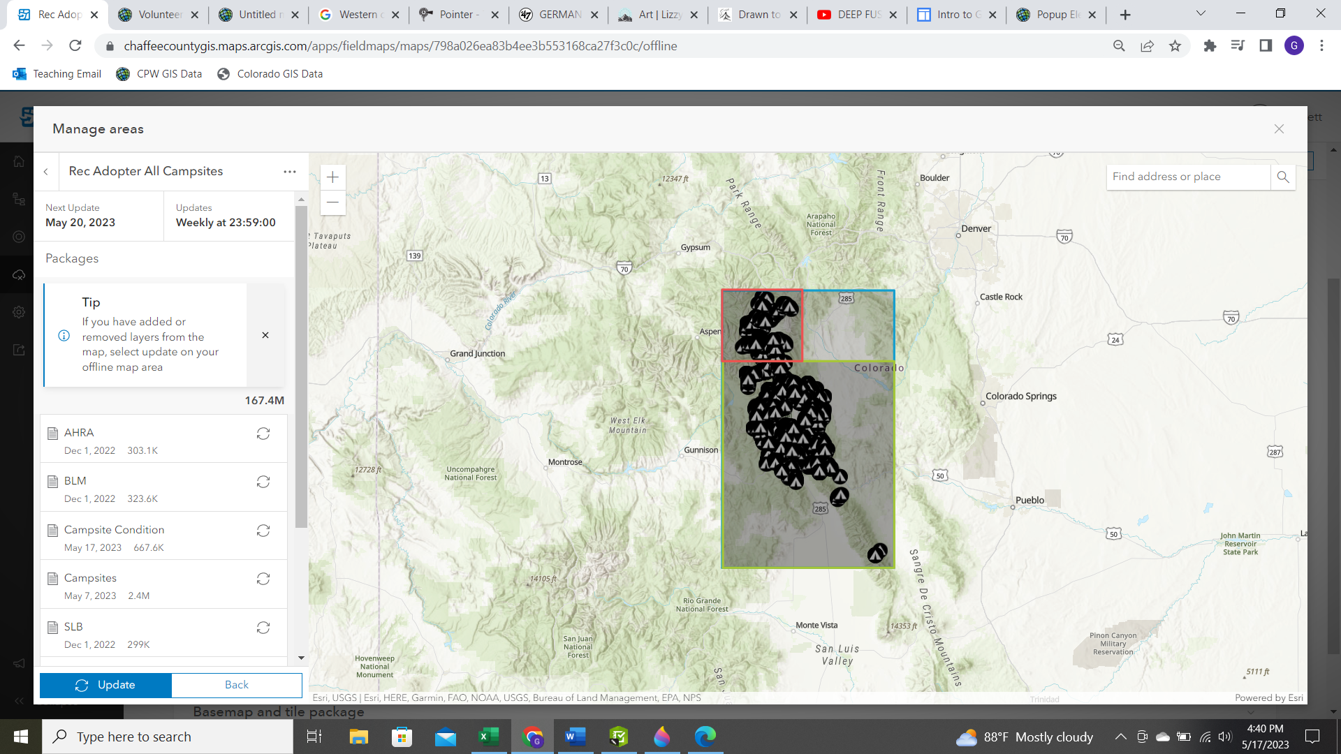

When I go into my Offline Map areas, after updating them, I do not see the Agency Actions Needed or the Volunteer Actions Needed layers:

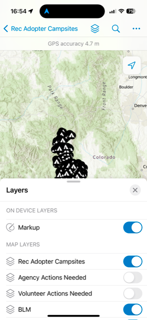

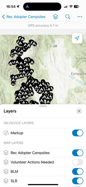

The same goes for when I open Field Maps on my phone. If I look at the online map, all the layers are there:
However, when I look at the offline map, there is only the Volunteer Actions needed layer.

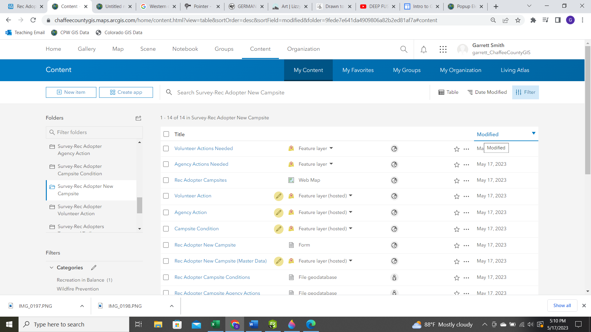

The only thing that I thought of was that both the Volunteer and Agency Actions Needed layers are created via the Campsite Condition layer using filters on two of the questions from the Campsite Condition table. In thinking that you are not able to create multiple layers from the same layer, I did a Save As from the ArcGIS Online Map and created separate feature layers for both.
I then re-added those newly created layers to the map and re-saved the online map and the offline areas in Field Maps, only to get the same results.

I went ahead and saved two Feature Layers (hosted, view) from the original Feature Layer and it is now working great.
I also noticed, before I did this, that there was a ghost table attached to my original Feature Layer. I found this out by looking at the table tab on ArcGIS Online. It was easy to delete this as well so that it would not cause any additional issues.
