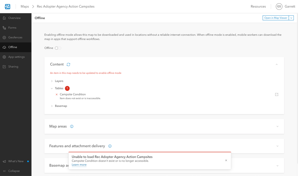

I am trying to create an offline map, and keep getting the following error stating that the table that is joined to the feature layer cannot be found:

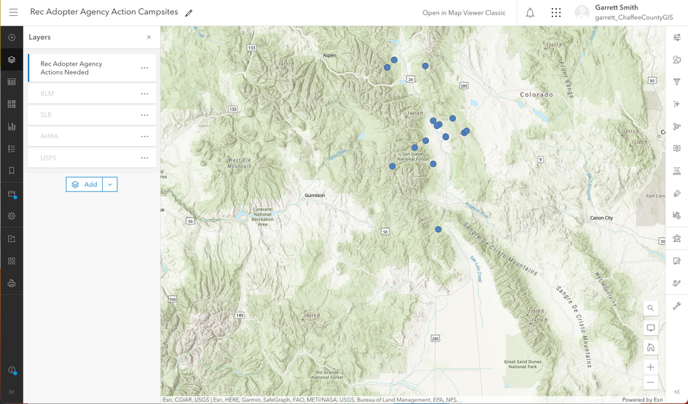

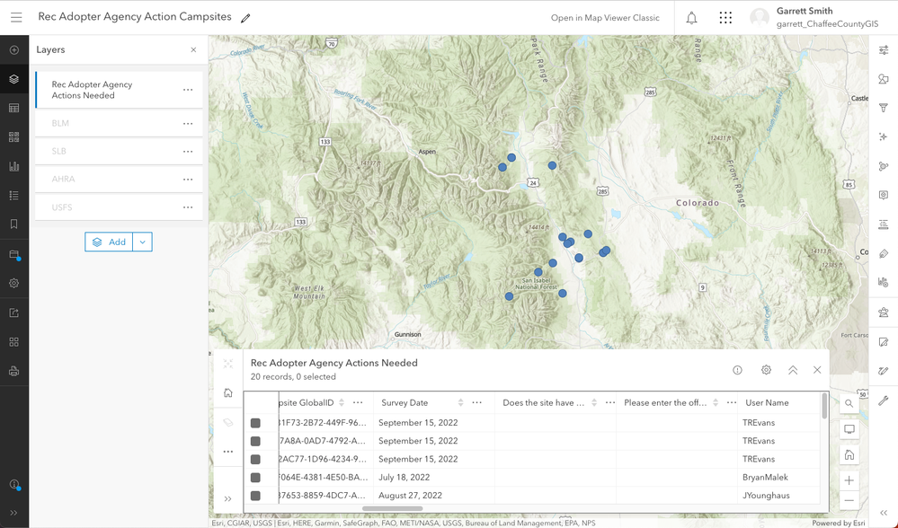

When I look at the table in the ArcGIS Online map it seems to be there:

ChristopherCounsell
MVP Frequent Contributor
There is a known limitation where Hosted Feature Layer Views created from the Map Viewer Classic Join Features analysis tool are not supported for offline use.
Standard Hosted Feature Layer Views support offline usage. Synchronization needs to be enabled on the parent layer first and then the view.
You can create a duplicate layer by unchecking the option to store the output of Join Features as a Hosted Feature Layer View, or run the analysis tools in ArcGIS Pro to reach the end result on the input layer.
