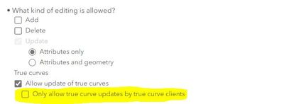

For the True Curves error you need to go to the setting of the layer and set the true curve options as below. Clikc save and return to Field Maps Designer and refresh view - the error should have resolved.
I was also experiencing the SQL keywords issues Thurs/Fri last week but it seems to have resolved over the weekend.

Mine is already checked but I am still receiving the error message in Field Maps Designer?
fitzpat_s
Untick the second check box beside "Only allow true curve updates by true curve clients"

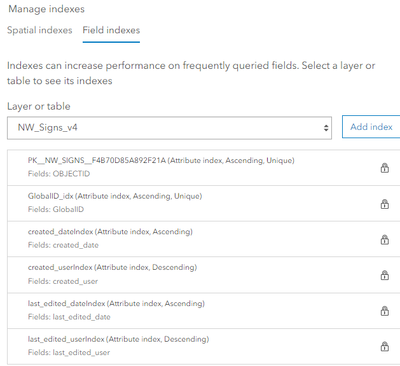

Has anyone figured out a solution for the Error that a "layer contains attribute indexes with unsupported characters and cannot be taken offline" - the only attribute indexes that exist on the layer are ESRI generated index for ObjectID, GlobalID, and the 4 editor tracking fields (Creation and Last Edits).
I didn't generate these indexes, and even though I'm an admin I am unable to remove the indexes because they are locked

Hey,
Just worked with an Esri Tech yesterday to resolve the padlock vs the trash can icon.
Long story short, currently the only resolution is to export the layer as an FGDB, and then republish it. This means the existing locked layer has to be removed from any maps, and any joins, views, etc. will have to be recreated with the new published layer.
Luckily for us, I have only found a few layers that this functionality was locked, but we have scores of maps we are going to need to review.
Best of luck in your endeavors.
