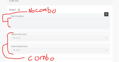

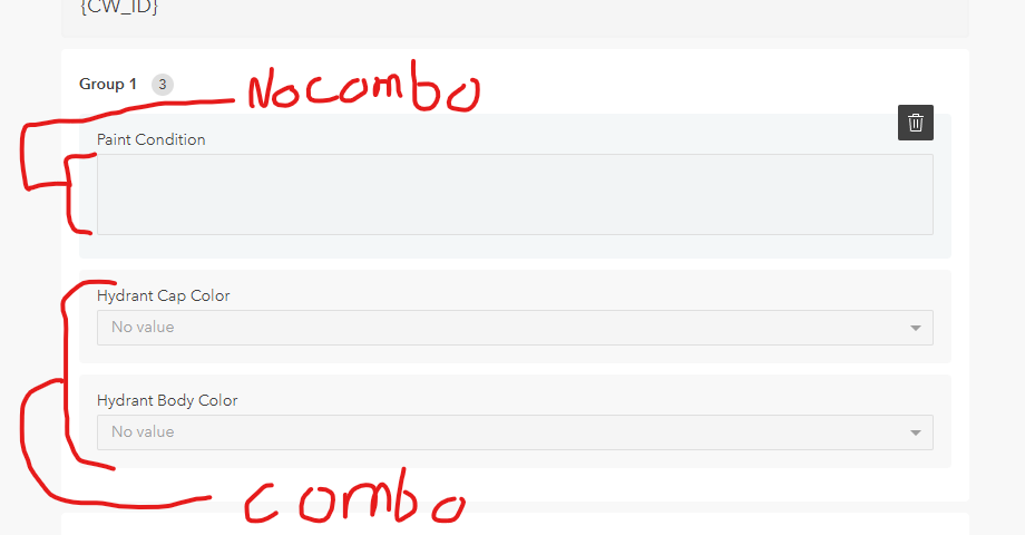

I'm setting up a workflow to edit attributes on hydrants in a Utility Network, and I'm getting some inconsistent behavior with combo boxes on fields with Coded Value Domains. What happens is some fields show the coded values as combo box, whereas others do not. The fields don't even have the option to set them as Combo Boxes in the form. In both cases, the domains are configured to only apply to the Fire Hydrants subtype. In this particular case, the fields that do work are Short Integer, and the one that doesn't is Text, but I've had similar situations where some Short fields work and others don't.
I know editing Utility Network features in Field Maps currently only has limited support, but this still seems odd. Has anyone found a solution for this?
