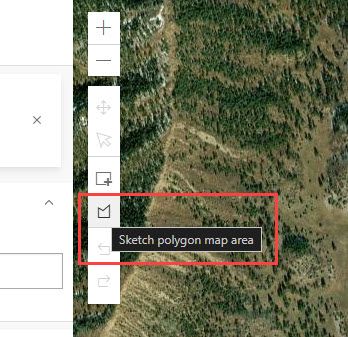

I'm trying to create offline maps for field crews in an area with no reception.

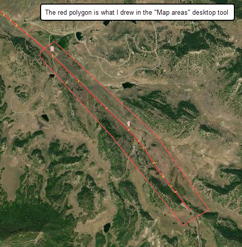

The area I'm trying to capture is not a perfect rectangular (I'm capturing areas around roads, linear events), so I'm using the "Sketch polygon map area" option to capture my area.

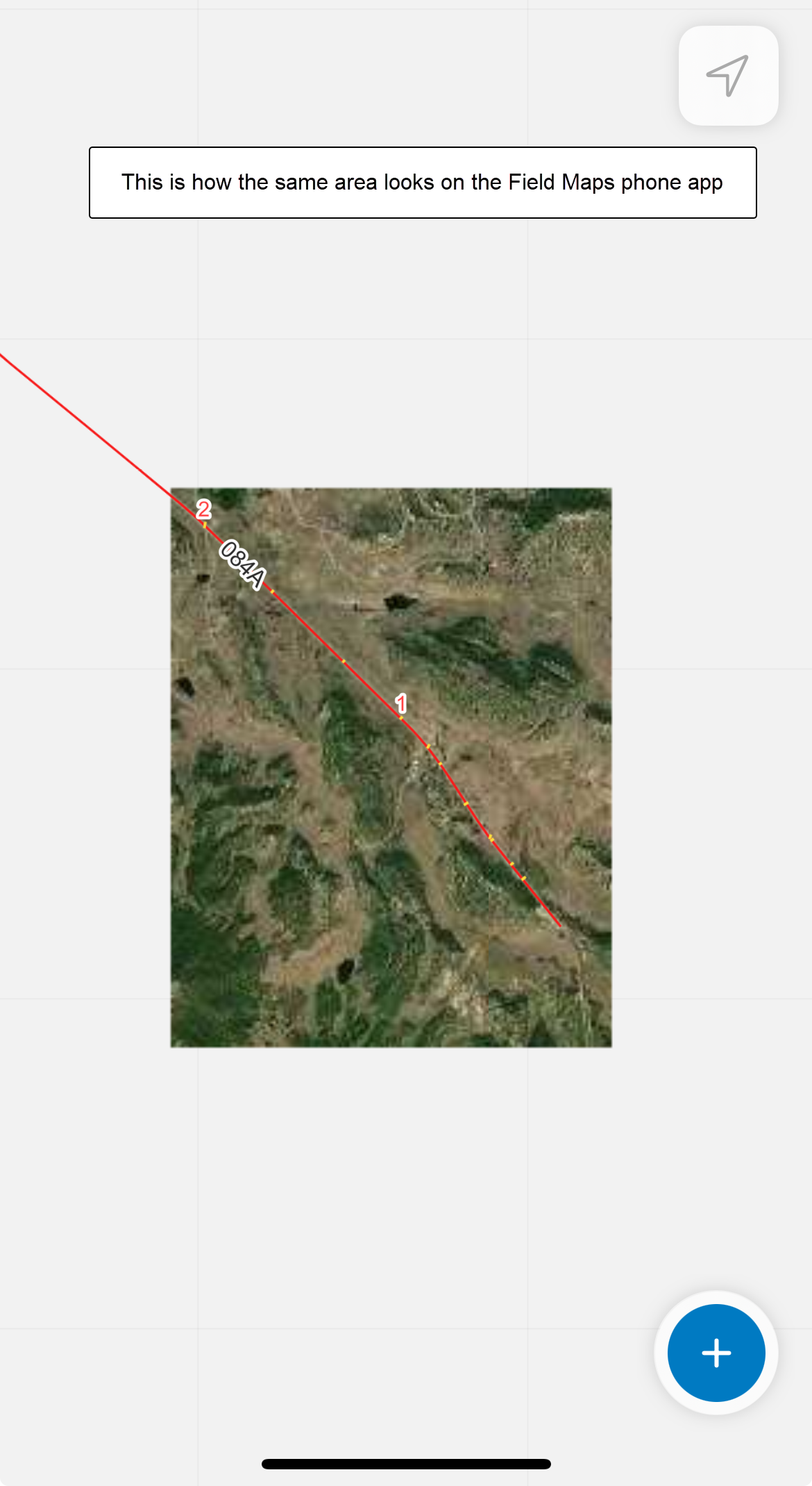

But each time the results (the offline map) come back as a rectangular shape, with 4 vertices, and not the original shape I drew on the map. See images below.
It appears that the tool picks 4 vertices from the odd rectangular shape I created and extrapolate it to a 4-corner rectangular.

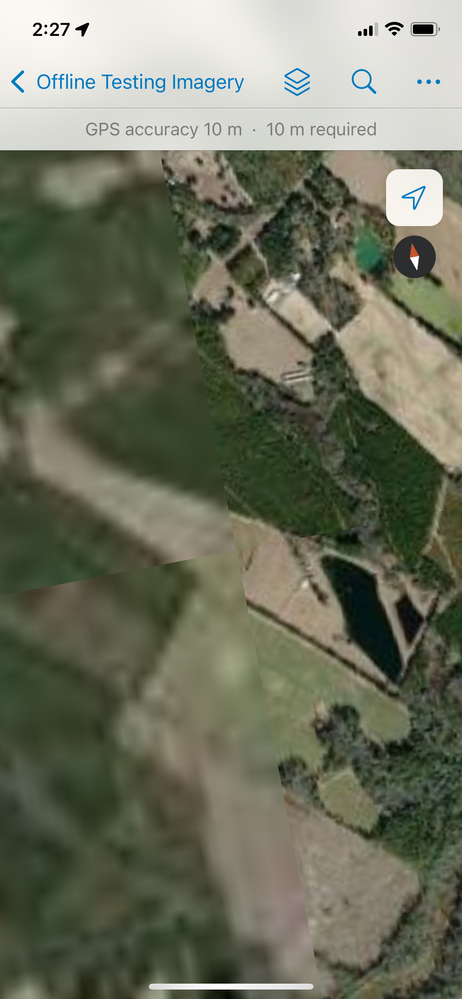

You’re very welcome, happy to help. As for your question about cropping the basemap, the tool is “cropping” or reducing the number of tiles included in the package, but in a slightly different way. If I were to create the same area using the rectangle tool verses the sketch polygon tool, the offline area using the sketch polygon tool will be smaller. However, instead of clipping the tiles to the outside of the polygon sketch area, whole tiles that intersect with the polygon at all levels of details are packaged. As you zoom into the map, the areas within the polygon sketch area will have more levels of detail downloaded, showing a clear imagery basemap, while the tiles outside will be more pixilated. The example below shows the areas in the polygon on the right and outside the polygon on the left.

@doronwen Thank you for the additional information. I've done some digging and this is excepted behavior. When using a raster tile basemap with the sketch polygon tool it will not clip the tiles and will return the whole tile for any tiles that fall within the sketch boundary, giving you the shape you are seeing.
