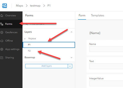

Yes, if you enable the 'Copy Shape' option in the Feature Actions under the app settings of Field Maps Designer
Then, once you have submitted the form for the marsh polygon, scroll down to the bottom of the popup and select the little squares with a plus sign and choose 'Copy Shape' (you may need to select the polygon first if it isn't).
Now, click on the template to create a new planted marsh polygon, and it will automatically copy the polygon to the planted marsh polygon layer and open the Form for the newly added polygon.

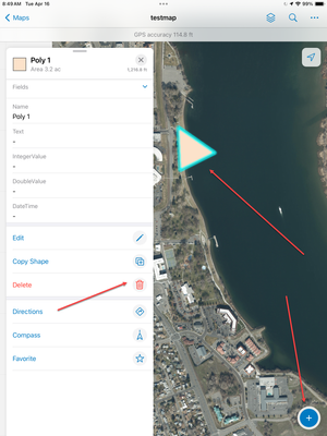

Once you have submitted your marsh zone polygon, it will show in the popup.  Or, if you have closed the popup, just click on the created polygon to select it (do not go into edit mode), then scroll down to the copy shape button.

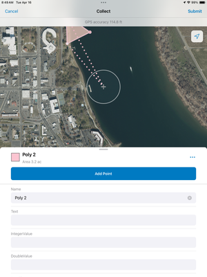

Create new polygon, then Copy Shape:
Now, press the add data plus sign, choose the Planted marsh template, and it will automatically copy the shape to that layer, and open up the form for the newly created shape.
(Just don't add point as it will add another point at your location to the copied shape)
Basically, everything is the same as adding a new planted marsh polygon, but have copied the shape before selecting the add planted marsh template.

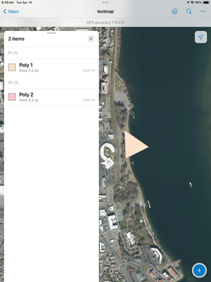

As you can see, there are two polygons here, but one is under the other so not visible.

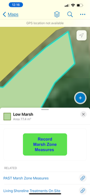

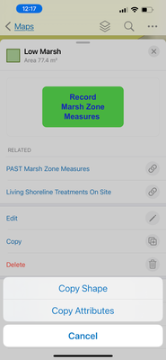

Hi again - Thank you for the detailed information! Unfortunately, after select my polygon from my Marsh Zone layer
then click on Copy Shape

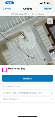

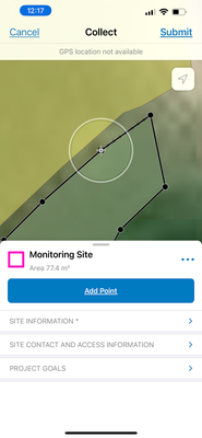

The menu for my main polygon - Monitoring Site pops up (my feature layer tables are related to the main feature layer with relationship tables). I don't see how I can click on the plus sign without canceling out of the copy.   And just for clarification, I want the shape to be the same, but the two polygons will have different attributes and fields.

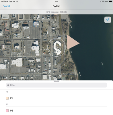

That is weird.  Currently, I'm not using any related tables in my Field Map apps, but in Field Maps App, all the editable layers that I have set up a Form for will show when I hit the Plus button.
The Form:
After hitting blue Plus button:
Once copied, I hit the Plus button, then select which layer I want it to copy to.

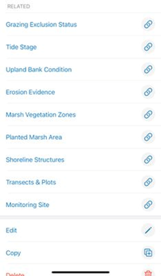

My Monitoring Site is my main polygon feature. To navigate in the app to the related features in the Monitoring site, you click the link icon at the bottom left of the app (image 1) that will take you to a list of my related features (image 2). The user then selects Planted Marsh and then the screen to add the planted marsh pops up (image 3).
RhettZufelt
MVP Notable Contributor
Well, I have avoided related features in AGOL due to several issues in the past, so not really sure how to help with this one.
In the second photo above (after you click the link in image 1), the list of related features comes up.  I see there is a copy button on that screen as well.  Curious what happens when you click that?  Does it give you the copy shape option, then you can click the Planted Marsh area and have it auto copy the feature?
