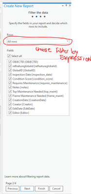

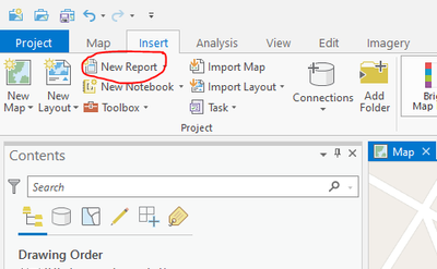

Bring the layer into ArcGIS Pro and create New Report
Then choose:
