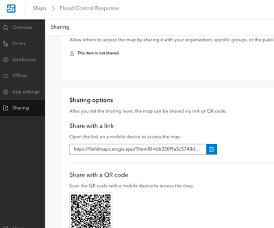

Hello @ArmstKP  - yes - the format is
https://fieldmaps.arcgis.app/?itemID=<item_id>&referenceContext=open&portalURL=https%3A%2F%2F<org>.arcgis.com
If you use Field Maps Designer you can find this link in your share tab
Also there is a video that talks about it around 5 minute mark (whole video is worth a look)
https://mediaspace.esri.com/media/t/1_0rni05by
You can find more documentation here: https://doc.arcgis.com/en/field-maps/latest/prepare-maps/deploy-your-map.htm

@JakeBrownMaps Thank you so much for this information!!  I had no idea that existed in the Field Maps Designer!
