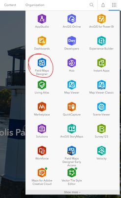

@luckachi This should be possible.  Have you used the Field Maps Designer before?  You can utilize an Arcade conditional visibility expression.  You can obtain the logged user, then you can set up an "if" expression, so that if the logged in user equals x,y,z, then make visible.....
