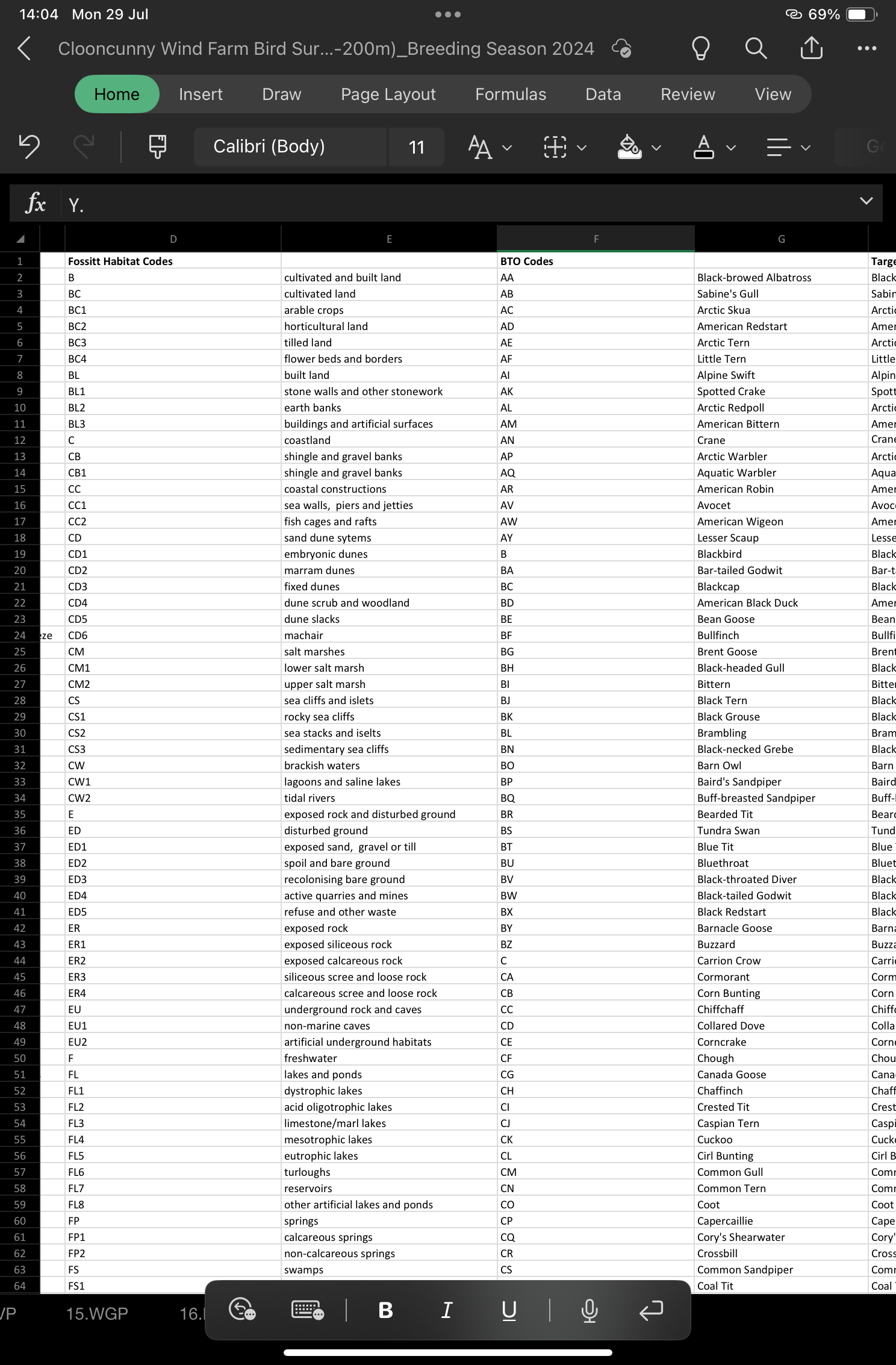

I have several lists of coded features (e.g. habitat codes and bird species codes; please see screenshot below) which I want to apply to drop down menus in Field Maps Designer to collect data in Field Maps. I would like to create a dropdown menu for each of the 2 code types  which will autopopulate the name in the next field in Field Maps.

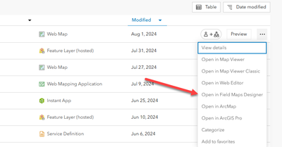

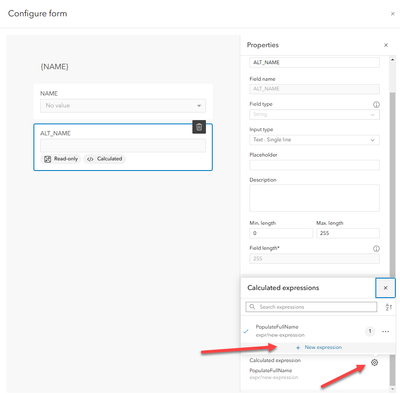

This button in the map viewer will open the Form editor:
Then, highlight the field you want to calculate the value for (in this case ALT_NAME):
and click + New expression.  (The check mark next to PopulateFullName means that expression is attached to the selected field)

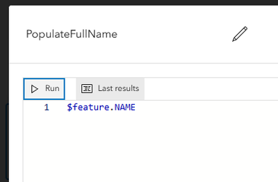

And this is what my expression look like:
Then Click OK and save the map.

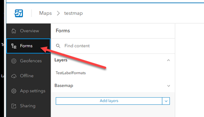

You can also edit the Form in Field Maps Designer:
R_

RhettZufelt
MVP Notable Contributor

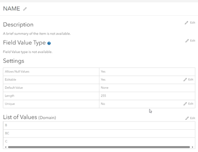

If you set up a Domain/Choice List on your first field (I used the NAME field):
Then in the edit Form, I have calculated value for the ALT_NAME field set to:
$feature.NAME

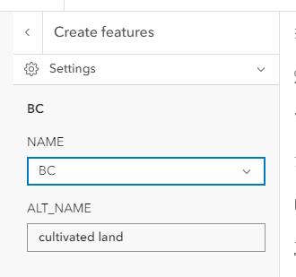

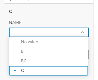

Then, when I add a feature and select the value from the dropdown in the NAME field:
The ALT_NAME field is automatically populated with the full name:
R_

RhettZufelt
R_
SarahJorgensen
@RhettZufelt Excellent! It worked! This exactly what I was looking for! Thanks for all your help.
