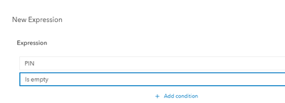

When you configure your form, the simple expression builder should be able to handle it.
And in Arcade, that's:
IsEmpty($feature["some_field"])
