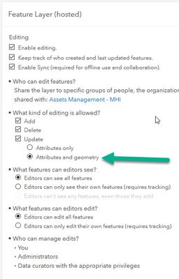

Hello Kimberly,
When you converted your colleagues dataset into a feature layer, did you set the settings to include Update Attributes and Geometry? if so you should see a button in field maps "Update Point".
The editor must  have editor rights, but if you can add content already that shouldn't be the problem.
Kind of new, so maybe I misunderstood.
KimberlyMeinert
Yep, I can update geometry and attributes, but it only seems to update the GPS fields on insert, not on an edit of an existing feature.
