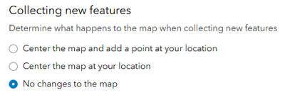

I had a similar need and decided to disable Collect Here all together as it just adds extra step as once you select it, it opens the same template picker box that the Add button does.
The only reason I could see wanting the Collect Here button was to add a point somewhere other than where the user is and if they picked the Add button, it would zoom them back to the GPS coordinate.
At some version, they added the option to make no changes to the map when collecting new features:
So now, when the hit the Add button, it behaves the same as the collect here, but will also auto assign the pole code as well.
Not sure if this will work for your situation, but in case it does....
