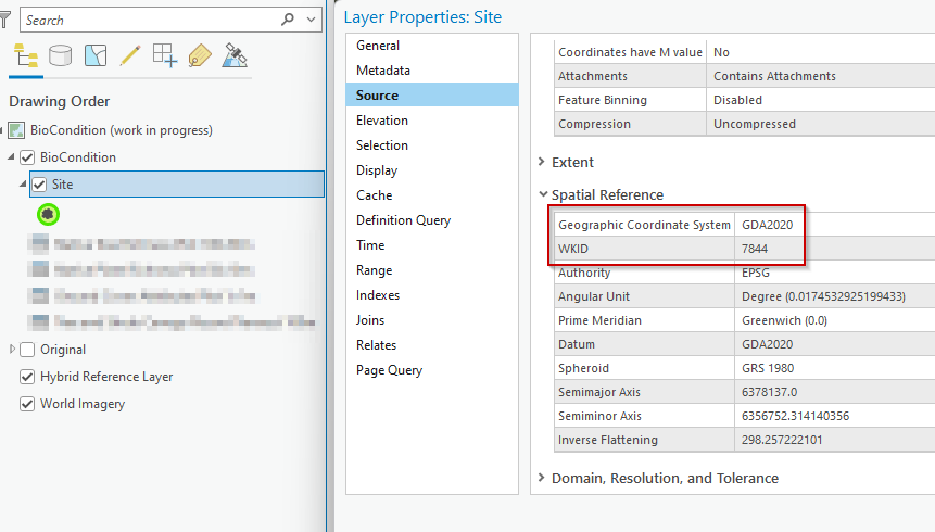

Was a simple map frame issue when publishing. Thought I had gda2020 setup but had wgs84.

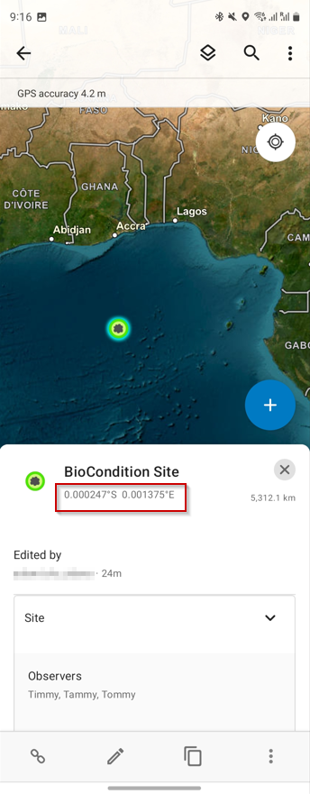

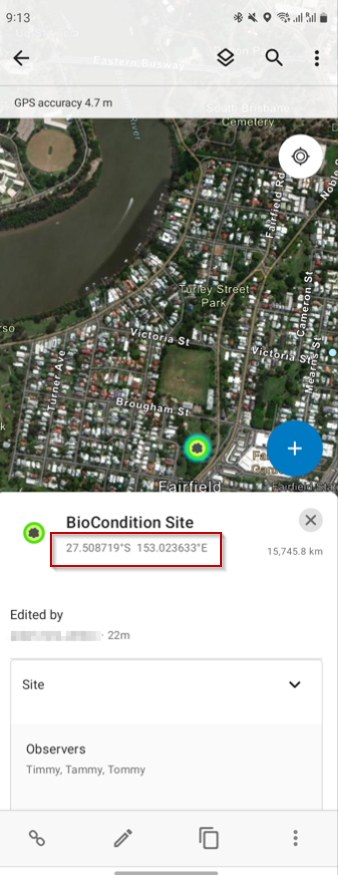

Looks like some kind of coordinate issue. Looks at the screenshots below and the coordinates returned for the same point. This point was captured in Map Viewer.

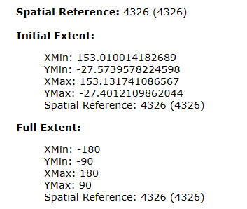

In Pro I have the layer setup in GDA2020 but after publishing, I checked the REST end point and it comes through in WGS84 as per the screenshots below. Tried publishing again and same issue.
