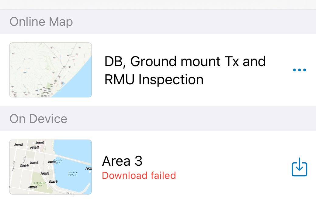

We have a map that contains a feature layer {point feature layer and related table (non-spatial) }

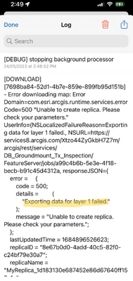

I can access the map fine but when I try to download and offline area it fails.
After that I thought, is something wrong in layer1 (related table). So I exported the feature layer as FGDB and reuploaded it to AGOL and created a TEST Map. Now this worked perfectly fine when I tried to download the offline area.
I compared the schema of the original feature layer and the TEST feature layer. I found some of the names had been truncated to 31 characters. Could this be the problem?

The next obvious step was to try and break the TEST layer. So created a new field with name of more than 31 characters. Then I tried downloading an offline area, the result was a fail with the same error.
Removed the troublesome field and I am able to download offline areas on my phone/iPAD.
