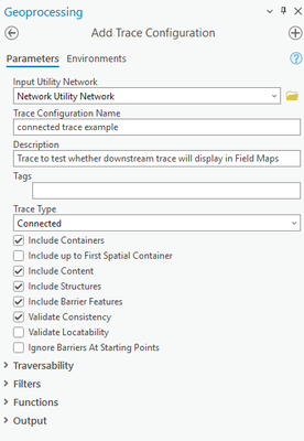

Hello,
Can you please provide a screenshot of the Add Trace Configuration tool configuration from ArcGIS Pro that was used to create the trace that was published with the map?
Thanks,
Ben
April_J
Thanks for response,
This is setting for trace downstream, other setting is the default value.
BenjaminSegal
Thanks for sharing the screenshots. I'm not seeing any issues with the trace configurations. A couple other questions:

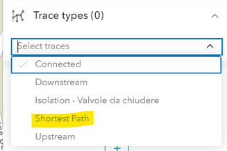

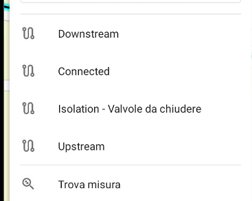

Same problem here, but slightly different. I see 5 Trace Configurations in Map Viewer / ExB, but I see only 4 of these in Field Maps. The "Shortest path" trace configuration is not visible.
Images: Map Viewer vs Field Maps
The only different thing I did is that the fifth Trace Configuration was created after some days, but I also tried republishing the web map from scratch... still 4 trace configurations...

BenjaminSegal
Hello @lzorloni ,
This is expected behavior with shortest path trace configurations. Field Maps does not support setting multiple start locations which is a requirement for a shortest path trace.
-Ben
