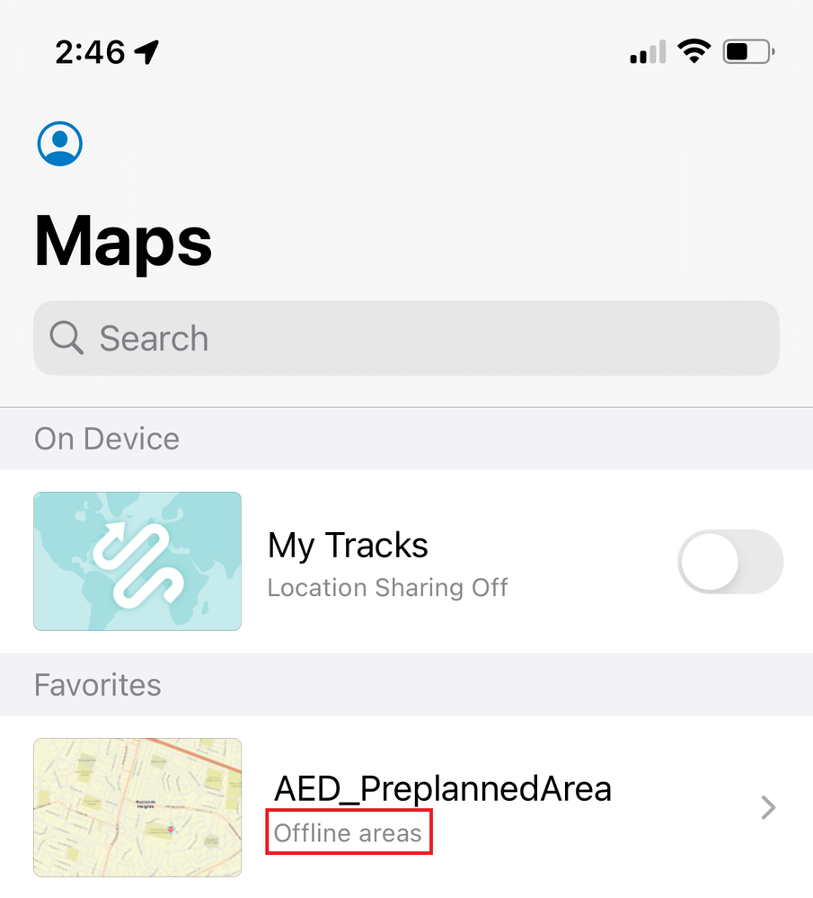

KerriRasmussen
Hi @PaulCone2  When you go to the Field Maps app, do you see the label Offline Areas under the name of your map? Once you create the offline areas using Field Maps Designer or in Map Viewer/Portal the offline area should show automatically in the app. One thing that does come to mind is to make sure that you refresh your maps in the app if you are already signed into the app. When you are on the browse screen (where you see a list of all the maps available), pull down on the screen to refresh your content. If you didn't do this before, that could be why you didn't see your offline areas available. If you did refresh and you still aren't seeing your offline areas, contact the Field Maps alias (arcgisfieldmaps@esri.com) and we can try some additional troubleshooting.
