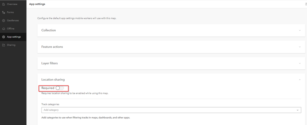

Not sure if you can do that but you can make a map only accessible once users are sharing their location. This way it can't be forgotten.

For options to try now.  One options would be to use the Location sharing required setting as AdamT suggested above.  Another option depending on your workflow/requirements could be to use geofencing to turn on location sharing or notify the user to turn it on as they approach certain areas.
