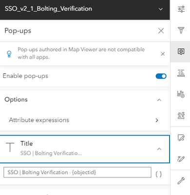

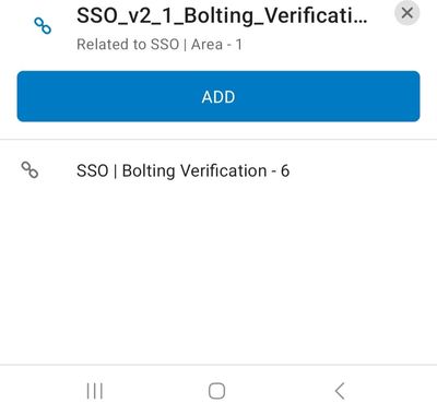

Hi @vegmap ,
You can actually achieve what you're describing by configuring a title on the related table when you are setting up the map in Map Viewer. The list that is presented in the related records view shows the title of each popup for the record, so if you use field substitution to bring fields into the title, whatever you configure will show up in that list.
I hope that helps!
Chris

Hi @vegmap ,
I hope that helps!
Chris
JustinReynolds
Yup. You could use the pipe symbol ("|") as your separator that may look like the following:
- Justin Reynolds, PE
