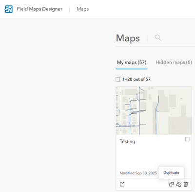

You can use the duplicate feature here in the Field Maps Designer location to duplicate the map and forms:
Cody
