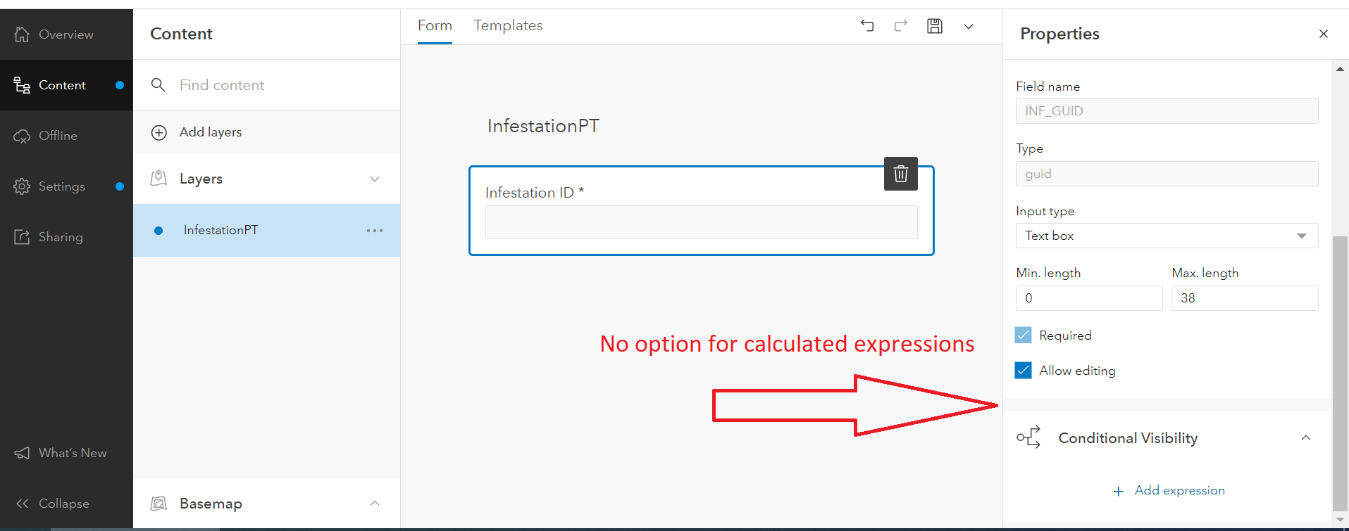

The option to create a calculated expression does not appear within field maps.  This should be an option as it appears in our dev & test environments for this feature class.  I'm not sure why the option isn't appearing because the dev/test/prod feature classes are identical, apart from the environment parameters the attribute rules are set up the same.

Hi @AaronSchuck1! Good afternoon. I'm assuming you are using ArcGIS Enterprise, since you have 3 different environments. Are all 3 at the same version? And what version(s) are you using?
AaronSchuck1
HI Kerri, thanks for responding.
Those were good questions to ask, our test environment recently got updated to 11.1, while prod is at 10.9.1
I think that's the reason the calculated expressions option isn't appearing in prod, but does that mean expressions will only execute when using conditional visibility?
KerriRasmussen
@AaronSchuck1 in 10.9.1 you will only be able to use conditional visibility expressions. For calculated expressions you would need to be on ArcGIS Enterprise 11.0 or higher.

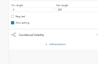

RobertBorchert
Honored Contributor
Below the arrow you have on your image select +Add expression
