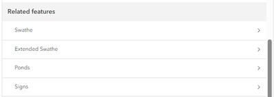

Thanks for commenting BlakeTerhune - I have tried to do this but i have numerous related layers going into one related table. See below screenshot when i try to use the related features:
So depending which layer the user with click on and add a related record to, I will need the ID field carried across - hopefully that makes a bit more sense?

Unfortunately not no, I tried the FeatureSet but because there are multiple, it fails to calculate
// Get the feature set for the hydrants
var maintenance = FeatureSetById($datastore,'ff83973e1a074d4ab758fce9d88f5339', ['Maintenance_Type'], false)
// Get the first hydrant (should only be one)
var maintenance2 = First(maintenance)
// If there was a hydrant, return the facilityid of it,
// Otherwise, return null
if (!IsEmpty(maintenance2)) {
    return maintenance2['Maintenance_Type']
} else {
    return null
