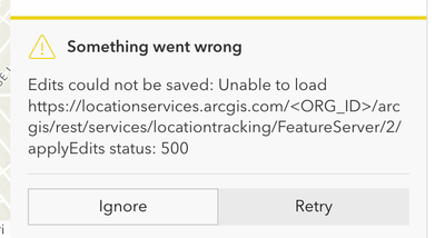

This is not possible.  It you attempt to update or delete a line feature it will not succeed, with an error similar to the image below.

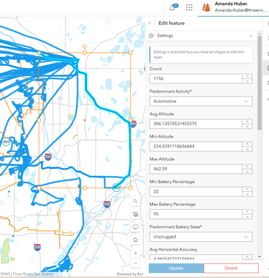

It appears when trying to edit the Tracker service directly though Map Viewer I am able to add or remove line segments manually but concerned if this will disrupt the overall product:
The autimatically created service:
What opening in Map Viewer, what editing looks like:
Can you clarify why this above is possible, and if I were to delete segments in the service via Map Viewer would I break anything with the overall process (or corrupt it)?

@Amanda__Huber sorry for the confusion.
Track lines are system maintained.  The only way they can be deleted is by following the instructions in the FAQ linked above, which would remove all data for specified users.
