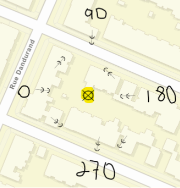

Hi all,
I'm looking to calculate the angle between 2 points. Both are in different services. The first one it's a pole location and the second one it's an anchor location.
The anchor location must have a particular symbol and should point to the pole. That's what i'm looking for. It's not just a "looking good" nice to have, we need that angle to use it on AutoCad drawing.
I'm using this code:

The results are not what I would have wished. First, the "North" at 0 degrees it's pointing West. Then at 0, 90, 180 degrees are looking good but not at 270 degrees. Between those numbers, none of the angles are correct. Here an example:
Any idea what is wrong or what I need to change...
 Thank you all!!

ErikRose
A couple issues:
  • Angle reference & direction
    • Atan2(deltaY, deltaX) gives the mathematical angle from the +X axis (East), measured counterclockwise. But you probably want a bearing measured clockwise from North.
  • Absolute value is breaking the quadrants
    • abs(180/PI) will always be positive and that’s fine for the constant—but if the expression ever included abs around your angle, it would erase the sign and collapse quadrants. Even for the constant, abs is unnecessary.
To convert the mathematical angle (from East, CCW) to a bearing (from North, CW), use:
bearing = (450 - degreesFromEastCCW) % 360
I can't test this on my end, but you want something like:
// Reference: Anchor feature geometry
var referencePoint = Geometry($feature);
// Feature set containing poles (replace "POLE" with your layer name if different)
var otherPoints = FeatureSetByName($map, "POLE");
// Guard: if there are no poles, bail out
if (Count(otherPoints) == 0) {
    return null;
// Find nearest pole to this anchor
var nearestPoint = null;
var minDist = Infinity;
for (var pointv in otherPoints) {
    var g = Geometry(pointv);
    var dist = Distance(referencePoint, g);
    if (dist < minDist) {
        minDist = dist;
        nearestPoint = g;
// If we found one, compute bearing (clockwise from North)
if (!IsEmpty(nearestPoint)) {
    var deltaY = nearestPoint.y - referencePoint.y;  // change in Northing
    var deltaX = nearestPoint.x - referencePoint.x;  // change in Easting
    // Mathematical angle from +X (East), CCW
    var angDegFromEastCCW = (Atan2(deltaY, deltaX) * 180 / PI + 360) % 360;
    // Convert to bearing: clockwise from North
    var bearing = (450 - angDegFromEastCCW) % 360;
    return bearing;  // degrees in [0, 360), North=0°, East=90°, South=180°, West=270°
} else {
    return null;
DavidSolari
MVP Regular Contributor
My faint memories of high school trig tell me something's wrong with how you're calculating the angle. Thankfully, nobody writing arcade has to remember how to do this right thanks to the Angle function. Replace the last few lines of calculations with Angle(referencePoint, nearestPoint) - 90 and you should be golden.
