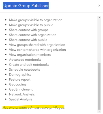

 admin privileges and shared update capability are separate mechanisms to give permissions to update content owned by other users. Maps and app updates supporting shared update shouldn't need admin privileges
Ed_
by MVP Regular Contributor
I hear you 🙂 but for some reason my role was that of a "Publisher" only so the Shared Update option wasn't appearing on my end I guess so the admin had to elevate my role and the option showed when I created a new report.
