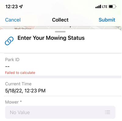

@Anonymous User  I used that code and it worked when I clicked the "Test" Button.  I saved it and then opened up Field Maps 22.2 and I get in red text, "Failed to calculate"

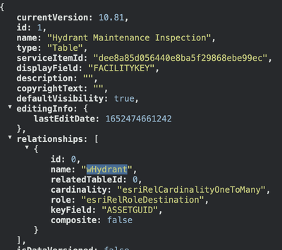

If you open the table JSON, you can find the relationship name.

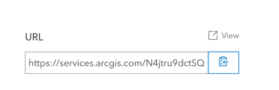

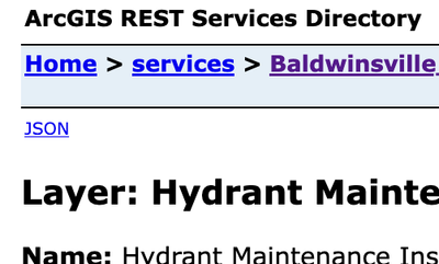

Go to the child layer/table page and click view in the bottom right:
Then in the upper left corner click json:
Then look for the relationships property and the name property within that, copy that and use it in your expression.
