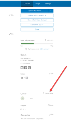

If you log in as owner/administrator, you can change the owner of the map in the item details page:
