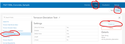

The option to have a switch, combo box, radio buttons is predicated on a field that has a domain (or list of values to choose from).  In other words, you must define your list of values first.  A field that has a domain will be a combo box by default.  That can be done in Pro before publishing the layer or if it is already published you can create the list of values on the data tab of the layer's item page.  Once this is done, you should then have the option to set the field to be one of the three options listed above.

This is exactly what I needed, thanks!
For anyone finding this afterwards, check out this article that helped me out as well:  https://doc.arcgis.com/en/arcgis-online/manage-data/define-attribute-lists-and-ranges.htm
