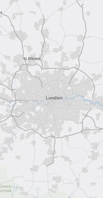

We have recently noticed that ArcGIS Field Maps does not display any copyright attribution/credits notice alongside the map or anywhere within the app (see below).
The Markup > Share screenshot option also produces a map image that does not include copyright attribution/credits (see below).

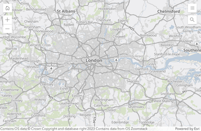

This appears to be contradictory most other ArcGIS apps (including Pro and web apps) where copyright attribution/credits is displayed, either as text or as an clickable/expandable area (see below for examples).

ArcGIS Web App (Instant App):
