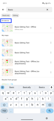

@AlfredBaldenweck does the "On device" section in Browse (found at the top or just under the current map card) list all of your maps that you have downloaded?  The "On device" section should also be present in your search results.

I suppose I missed it haha. I think you could probably mark this as "Already Offered".
JustinColville
The "On device" section in Browse lists your maps that you have downloaded.
