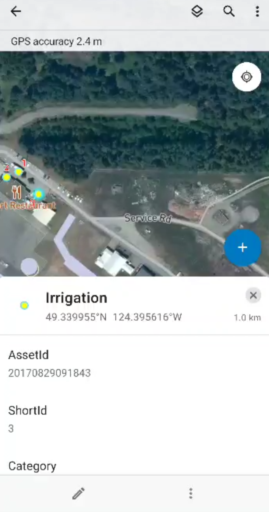

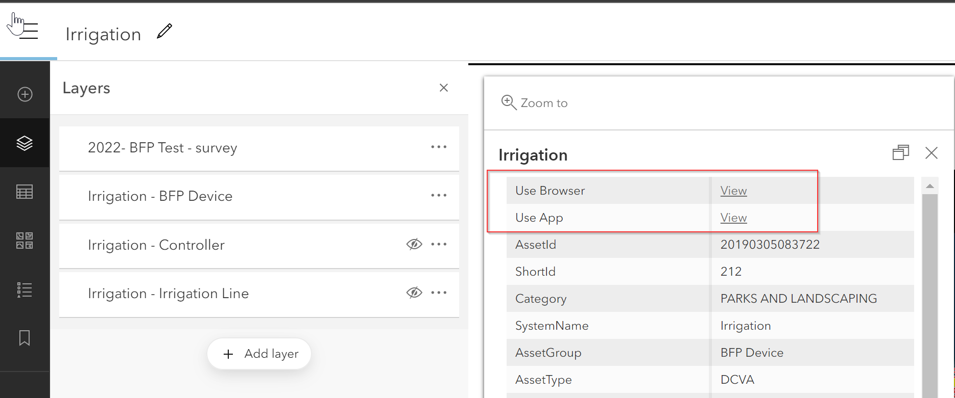

I made expression to generate links to Survey123 survey with latitude, and longitude. However, my expression fields are not displayed in the same order that I had on Pro and New Web Maps...they are put at the cold bottom after all other attributes.
Web Map/Pro can display with my configured order

I need to scroll to the bottom to find my expression made links.

The issue is that Field Maps doesn't support the newer pop-up formats that Map Viewer and Pro author. This is something we just started work on and plan to deliver later this year. If you use Map Viewer classic to configure the pop-up, the order should be respected.

Thanks! It resolves the issue! Hope Field Maps will support new Map Viewer and Pro soon.
