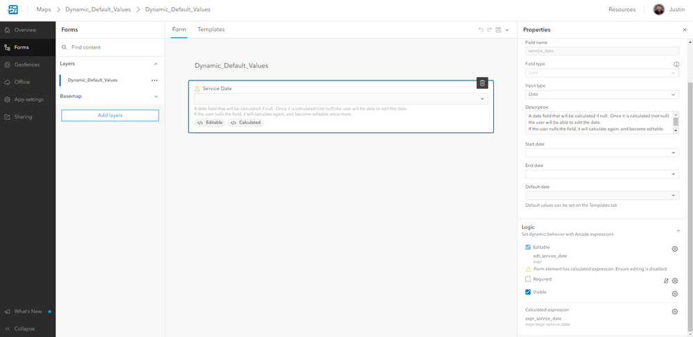

Here is how it worked a month or so ago.
The overall setup... Shown using AGO.
The overall setupThe overall setup

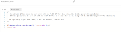

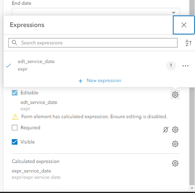

The editableExpression

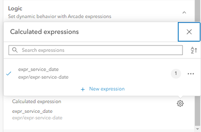

The form calculation
