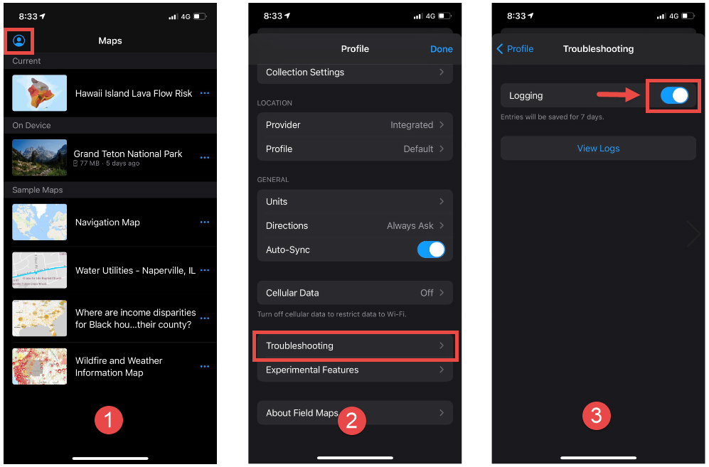

  1. Log into the ArcGIS Field Maps mobile app and go to your profile menu
  2. Go to 'Troubleshooting'
  3. Enable 'Logging'

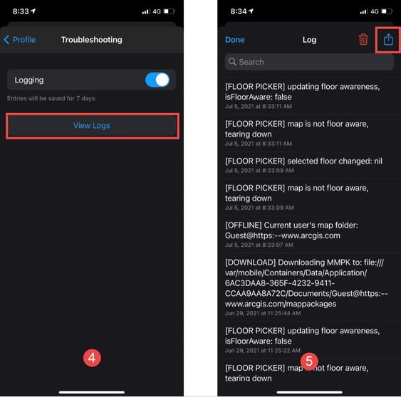

4. Go back to the 'Troubleshooting' settings page and click 'View Logs'
5. Use the button in the top-right hand corner to export the log file
