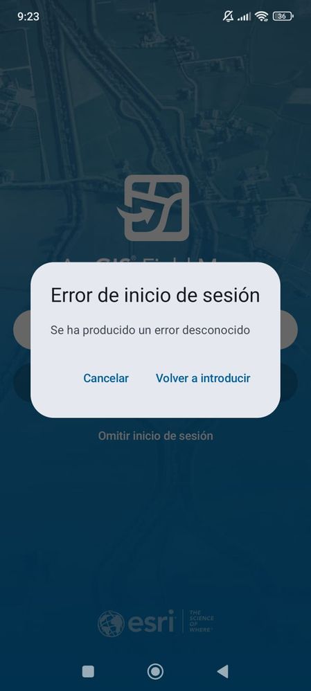

Hello everybody, good morning!
In our case, the login problem arises only with ArcGIS Enterprise 10.9.1 when using Android OS and the Field Maps app version 25.2.0 or higher (including 25.2.3).
I also tested it against ArcGIS Enterprise 11.2, and the login problem did not occur.
When we use Field Maps version 25.1.0, everything works fine!

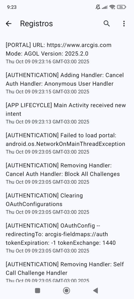

MiaogengZhang
@emarcelloni The log is similar to this https://support.esri.com/en-us/bug/android-users-are-unable-to-log-into-certain-arcgis-ent-bug-00017.... Is it SAML with Enterprise 10.9.1? If so, we are working on a fix for that.

emarcelloni
Hello @MiaogengZhang good morning!
Yes, we have SAML configured in our ArcGis Enterprise 10.9.1
