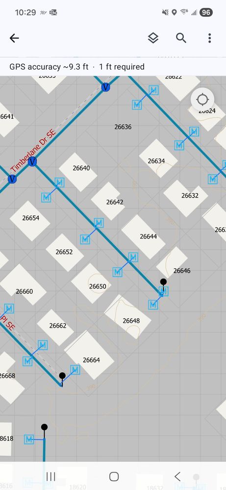

Unfortunately, since today, more than 300 of our field technicians are unable to sign in to ArcGIS Enterprise using the new FieldMaps app on iOS and Android.
We are using Enterprise Login and have tested the behavior against ArcGIS Enterprise versions 11.3 and 11.5.
This issue is significantly impacting our daily operations as a utility network operator for electricity and gas in Germany. We have already opened a support case with Esri Germany (Esri Case #04012154).
On iOS, the error message displayed is: "Invalid redirect URI".
Is this a bug in the new version, or do we need to adjust our portal configuration?

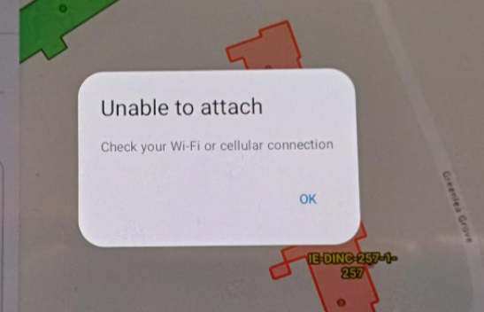

Hey, a lot of my field workers are on Android version 25.2 and are experiencing an issue with a particular map which worked fine before the update.
When clicking on take photo or attach (anything) the following error is shown:

@Mattmillos84 ,
For the "unable to attach" issue you are seeing, that has been reported by others and we are actively working on a fix. If you haven't already, opening a case with support will be the best way to be informed of when there is a fix available.
