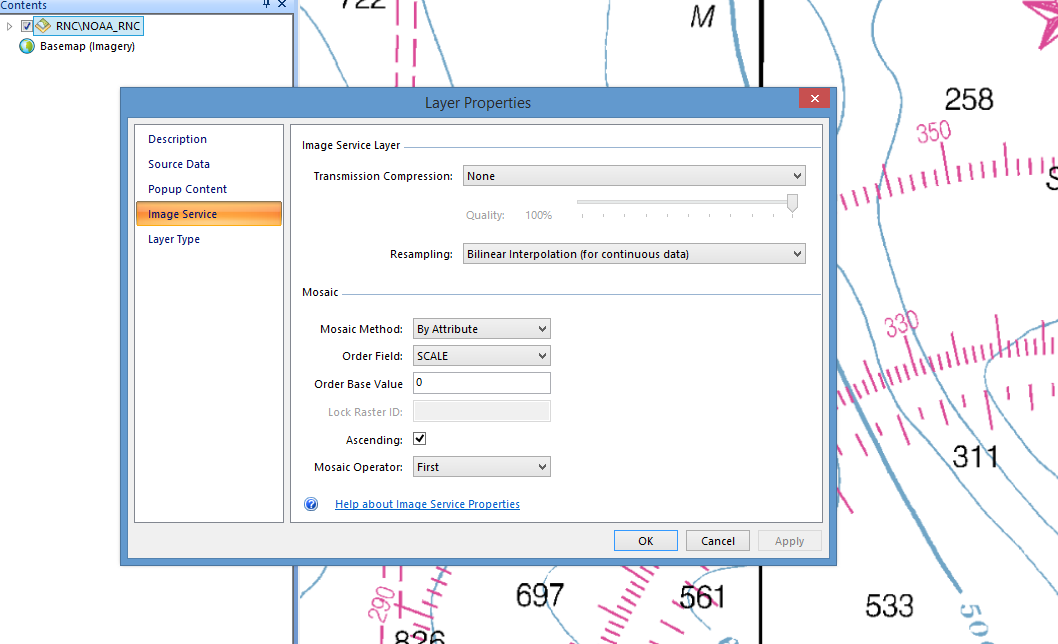

I see the same issue in ArcGIS Explorer Desktop 2505.  (the problem does not occur in the software we are working on for the next release).  I notice that their is an image service that does work.  NMC example here.  http://www.arcgis.com/home/item.html?id=7b2e147e7e204b6193c80caa0fff8d36
Setting the image service properties as follows, will get it displaying the same as the Map Service.
