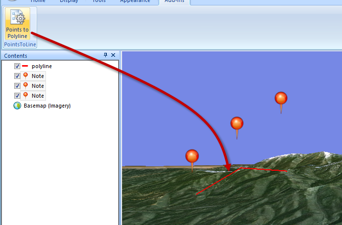

This is very much a workaround....
You could create point notes and set them to an absolute height.
Then use this Add-in  Points to Line.
http://www.arcgis.com/home/item.html?id=cbac8eb455364bbbaf931f75218c9b31

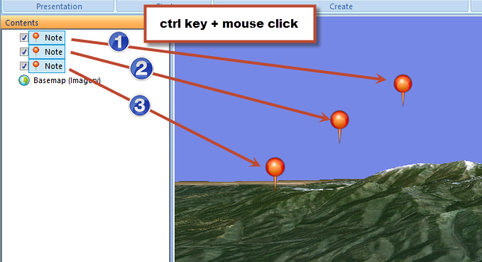

In the table of contents ctrl + click the Note points in the order you want to draw the line.
Then use the Add-in and press the button on the ribbon.  It will add a line note in the order the notes were clicked., "Connecting the Dots"
the line will be drawn on the ground.

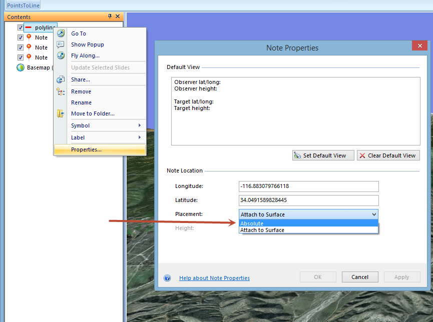

Right Click on the line note in the table of contents, Click Properties and set it's placement to Absolute.
The line will now connect the dots in 3D.
