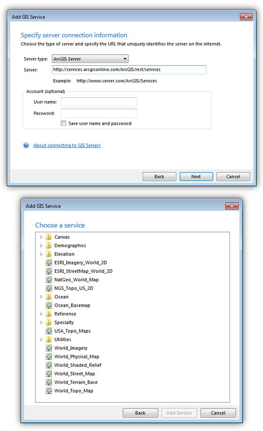

JoeFlannery
Honored Contributor
Alternatively, go to >Add Content >GIS Services and add the ArcGIS Online REST Services URL (http://services.arcgisonline.com/ArcGIS/rest/services) then choose the map background you are looking for.
TomLaidlaw
Deactivated User
The link doesn't work
JoeFlannery
Honored Contributor
Try lower-case "arcgis" in the URL.
Like this:
http://services.arcgisonline.com/arcgis/rest/services
