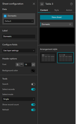

I have set up an experience builder app, and I want users to be able to select a record in the attribute table and then zoom to the feature on the map.
I have applied the data and attribute actions to 'zoom' to map 1 in the attribute table widget config, but it still does not work. Is this because I am using map image layers and not feature layers in the app?.

You should definitely be able to do it with map image layers. Can you share a screenshot of the widget config please?

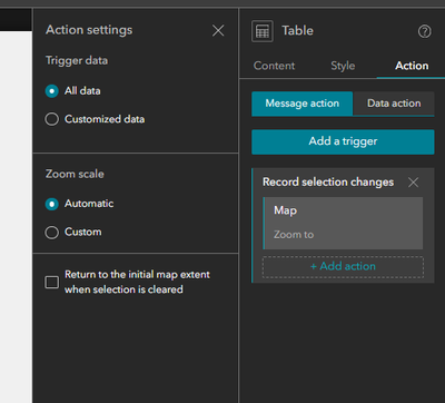

May I ask what version you are using? I tested this out with a map of mine that only uses Map Image layers, no feature, and I have no problem configuring the zoom to action like you have above. Is it possible there's something amiss with the Action settings when you click on the Record selection changes action? Here's what mine looks like (dev edition 1.16):

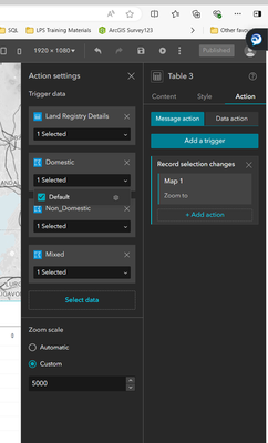

11.3 Enterprise, I really am hoping it's something simple...
Set the actions as below;

Honestly, this really looks like it should be working. I found a bug that is specific to the search widget in this version where if there are more than one layer as a possible input, then the zoom to doesn't work.
https://support.esri.com/en-us/bug/the-zoom-to-action-in-the-arcgis-experience-builder-sea-bug-00017...
Now these are totally different widgets but just for kicks, what happens if the only trigger data in that list is "Domestic"?

It was a good theory but still no luck! I'll log it with ESRI support to see if they can confirm it's a bug with this version, just so strange, as the zoom to works with no selection i.e. zoom to all the data in the attribute table!

I just had this same issue in Enterprise 11.5. Found this post in my hunt for a solution, but eventually worked out the problem myself.
In the Action Settings, I found it you choose Customized Data, if you don't remove the 'None' option, it doesn't work. Delete 'None' and just leave the layer you are trying to zoom to and it works fine
