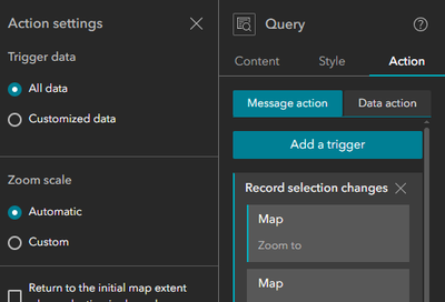

I can confirm that it does work. Can you confirm what you have selected for trigger data? if it is customized data you need to ensure that all of your layers are selected.
Maybe the zoom scale isn't working for what you need. Have you tried custom zoom scales to see if that makes any difference?

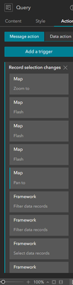

Unfortunately for flash in my case I had to add it in for each layer because I wanted the query to select a different layer on my map to flash so I had to set up my trigger and action data for each one.

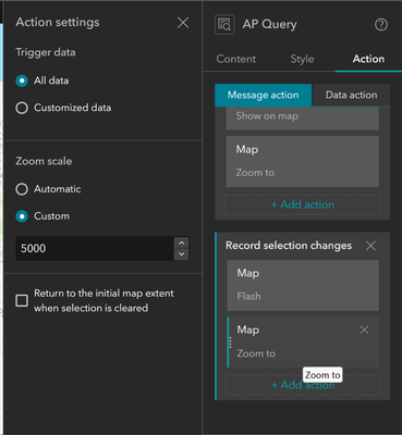

Hi laura,
Thanks for that. These are my settings, which seem to be the same as yours, except for the scale, which I'd set to 1:5000 previously.
The first zoom works fine, but after that it goes to random points.
There is never any secondary highlighting for the specific feature, rather than the whole selection.

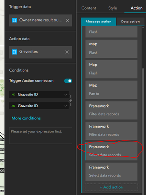

As far as this goes: Also, although I’ve changed the settings in ‘Map – Options’ there is no highlight around the feature, again as there used to be in WAB.
I'm wondering if you went into add action - framework - selection data records if it would then work for you because based on your screenshot i don't see that in your message action.

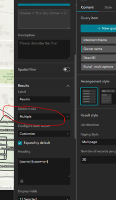

What do you mean by first zoom? If the query comes up with say 2 results when you click on the first one everything is fine but when you click on the second it doesn't work? Are you allowing single or multiple in the results select mode?
SimonCrutchley
Hi Laura,
I'm afraid I don't fully understand what the various options within 'Framework' do.
As for the second question, yes. Queries generally pull up between 20 - 100 images which I have in a filmstrip, so these are 'multiple'. Clicking on the first one works, but after that it becomes random.

So your results has this? Multiple?
It will then zoom out so all selected (multiple) can be viewed rather than the latest click.

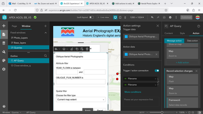

SimonCrutchley
Hi Laura,
I've tried to replicate this, although I'm not entirely sure what I'm doing.
However, it doesn't seem to have had any effect and the zoom still fails.
Am I doing something wrong?
