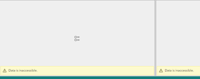

Hi,
I have created a webmap and used this map in an ExB. I use a list widget to give an overview of polygons in a feature layer.
After I have reordered  the feature layers in the webmap, made groups in the webmap, the list widget gives the error "Data is inaccessible". This means I have to go through the list widget(s) to reconnect the data.
This also is occurring with the Edit widget
update: Esri Case #03695550

Additional Information:  ArcGIS Experience Builder references datasets in a web map via a Data Source ID created for that specific data source, and rearranging layers in a map into Groups updated/modifies that data source ID, breaking the connection between the layers in the web map and the Data Source ID.
Ke_Xu
by Esri Regular Contributor
Hi Stefan_Thorn,
In brief, feature layer and group layer are different layer type. So at first, the widgets read the layer as feature layer, then layer type changed, the widgets couldn't read it. You need to reconnect the data again.
