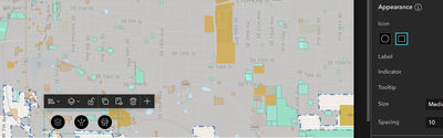

Not sure exactly how the icon appearance is supposed to work on the contents settings of the Widget controller. When i change the icon appearance from a circle to a square the widget icons don't change shape, they just space out a little more. Does anyone understand this setting better or are you seeing the same issues.

@DerekFarr I assume you were using the Violet theme? If so, this is a bug that we will fix in the next online release.

I see the shapes change. Maybe your background color is too similar to the color of the buttons, so you can't really see it.

Thank you for your response. I can change the widget shape in other Experience builder projects, but not the one I'm trying to change it in. This is what i get.

Thank you very much. I was in fact using the Violet theme.
