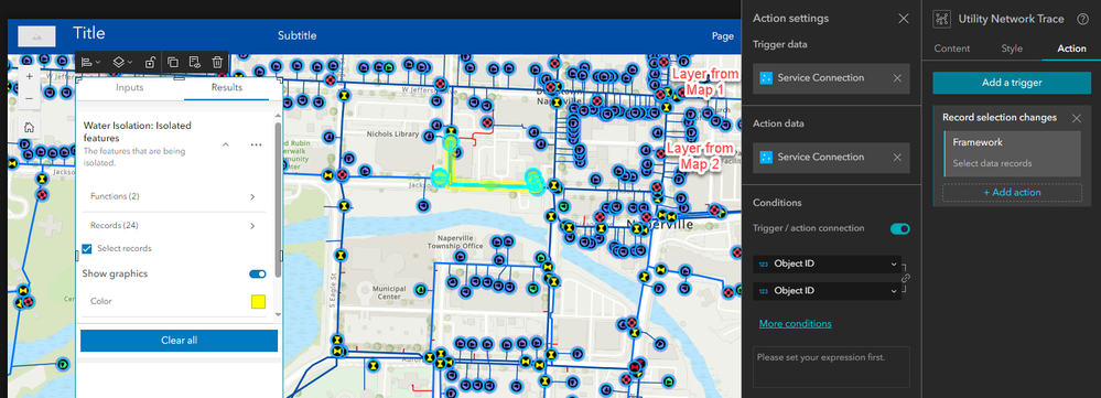

I use two separate Map widgets and setup action record selection changes between UN map and Scene in Map widgets. I notice that my Utility Network Trace widget doesn't have Action tab and trace result was as shown in the attached picture.

@April_J The Action button for the Utility Network Trace widget was added at a later release. You'll find them in the current release of  ArcGIS Online and in Enterprise 11.3 (once released in May). You can also use the developer edition of Experience Builder to leverage the latest functionality.
